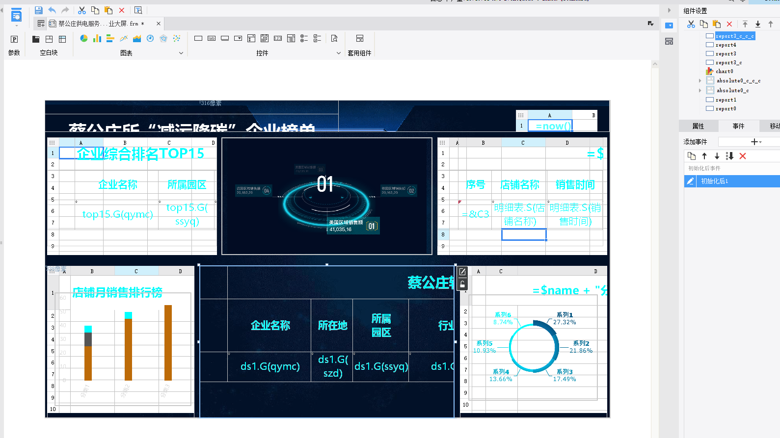

隐藏滚动条并动态轮播效果问题
setTimeout(function() {
$("div[widgetname=REPORT3_C_C_C]").find("#frozen-center").css('overflow-x', 'hidden');
$("div[widgetname=REPORT3_C_C_C]").find("#frozen-center").css('overflow-y', 'hidden');
$("div[widgetname=REPORT3_C_C_C]").find("#frozen-north").css('overflow-x', 'hidden');
$("div[widgetname=REPORT3_C_C_C]").find("#frozen-north").css('overflow-y', 'hidden');
$("div[widgetname=REPORT3_C_C_C]").find(".reportContent").css('overflow-y', 'hidden');
$("div[widgetname=REPORT3_C_C_C]").find(".reportContent").css('overflow-x', 'hidden');
}, 500);
window.flag = true;
$("#frozen-center").mouseover(function() {
window.flag = false;
//鼠标悬停,滚动停止
$("#frozen-center").mouseleave(function() {
window.flag = true;
//鼠标离开,继续滚动
var old = -1;
var interval = setInterval(function() {
if (window.flag) {
currentpos = $("#frozen-center")[0].scrollTop;
if (currentpos == old) {
$("#frozen-center")[0].scrollTop = 0;
} else {
old = currentpos;
$("#frozen-center")[0].scrollTop = currentpos + 1.5;
}, 100);
//以25ms的速度每次滚动3.5PX
}, 1000)
正下方表格不滚动,请问是什么问题?
FineReport BooMer 发布于 2022-6-6 15:13 (编辑于 2022-6-6 15:14)
发布于2022-6-6 15:14(编辑于 2022-6-6 15:46)
你是不是报表块没有设置冻结行,检查报表块名称对不对
这个是需要报表块有冻结行才可以
    //隐藏报表块REPORT0的滚动条(此报表块名为REPORT0,根据具体情况修改)
    $("div[widgetname=REPORT0]").find(".frozen-north")[0].style.overflow = "hidden";
    $("div[widgetname=REPORT0]").find(".frozen-center")[0].style.overflow = "hidden";
}, 1000);
window.flag = true;
//鼠标悬停,滚动停止
    $(".frozen-center").mouseover(function() {
    //鼠标离开,继续滚动
    $(".frozen-center").mouseleave(function() {
        window.flag = true;
    var old = -1;
        if(window.flag) {
            currentpos = $("div[widgetname=REPORT0]").find(".frozen-center")[0].scrollTop;
            if(currentpos == old) {
                $("div[widgetname=REPORT0]").find(".frozen-center")[0].scrollTop = 0;
            } else {
                old = currentpos;
                //以25ms的速度每次滚动1.5PX
                $("div[widgetname=REPORT0]").find(".frozen-center")[0].scrollTop = currentpos + 1.5;
    }, 25);
}, 1000);
  • BooMer BooMer(提问者) 设置了冻结行,报表块名称也没问题
    2022-06-06 15:41
  • BooMer BooMer(提问者) 滚动条已经隐藏掉了,但是不自动滚动
    2022-06-06 15:42
  • snrtuemc snrtuemc 回复 BooMer(提问者) 按我的语句试试,推荐谷歌浏览器
    2022-06-06 15:47
  • BooMer BooMer(提问者) 回复 snrtuemc 可以了 感谢感谢抱拳
    2022-06-06 15:57
