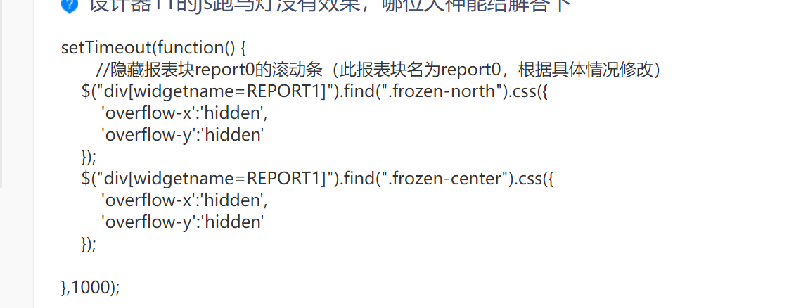

设计器11的js跑马灯没有效果,哪位大神能给解答下
setTimeout(function() {
       //隐藏报表块report0的滚动条(此报表块名为report0,根据具体情况修改)
    $("div[widgetname=REPORT1]").find(".frozen-north").css({
        'overflow-x':'hidden',
        'overflow-y':'hidden'
    $("div[widgetname=REPORT1]").find(".frozen-center").css({
},1000);
window.flag1 = true;
var self1 = this;
//鼠标悬停,滚动停止
    $("div[widgetname=REPORT1]").find(".frozen-center").mouseover(function() {
        window.flag1 = false;
    //鼠标离开,继续滚动
    $("div[widgetname=REPORT1]").find(".frozen-center").mouseleave(function() {
    var old = -1;
    var interval = setInterval(function() {
        if (!self1.isVisible()) {
            return;
        if (window.flag1) {
            currentpos1 = $("div[widgetname=REPORT1]").find(".frozen-center")[0].scrollTop;
            if (currentpos1 == old && 0!=currentpos1) {
                $("div[widgetname=REPORT1]").find(".frozen-center")[0].scrollTop = 0;
            } else {
                old = currentpos1;
                //以25ms的速度每次滚动1.5PX
                $("div[widgetname=REPORT1]").find(".frozen-center")[0].scrollTop = currentpos1 + 1.5;
    25);
1000);

用户6NWif5139660Lv6资深互助
发布于2022-6-28 11:15(编辑于 2022-6-28 11:23)
https://bbs.fanruan.com/wenda/question/16925.html
参考
这些改了
setTimeout(function(){
 _g().getWidgetByName('report0').startMarquee()},
500);
s
