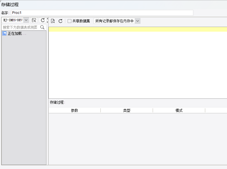

本地环境存储过程数据集无法显示
如下图,同时设计器有报错
本地环境
如果不用点选的方式,是否有其他方式可以引用存储过程数据集?
    2023-08-28 11:54:58严重:11:54:58 FinePluginController-23-worker-1 ERROR [standard] plugin: com.fr.plugin.assistant version: 1.2.22 update failed 2023-08-28 11:55:00严重:11:55:00 localhost-startStop-1 ERROR [standard] Job class not found, jobKey: DATA_PREPARE.DATA_PREPARE_FR-FB001. 2023-08-28 11:55:00严重:11:55:00 localhost-startStop-1 ERROR [standard] [Schedule] Error retrieving job, setting trigger DATA_PREPARE.DATA_PREPARE_FR-FB001 state to ERROR 2023-08-28 11:55:30严重:11:55:30 SwingWorker-pool-6-thread-8 ERROR [standard] 错误代码:31300012 创建数据连接失败: interrupt 2023-08-28 11:55:37严重:11:55:37 SwingWorker-pool-6-thread-5 ERROR [standard] IO 错误: Socket read interrupted 2023-08-28 11:55:37严重:11:55:37 SwingWorker-pool-6-thread-4 ERROR [standard] IO 错误: Socket read interrupted 2023-08-28 11:56:45严重:11:56:45 SwingWorker-pool-6-thread-10 ERROR [standard] 错误代码:31300012 创建数据连接失败: interrupt

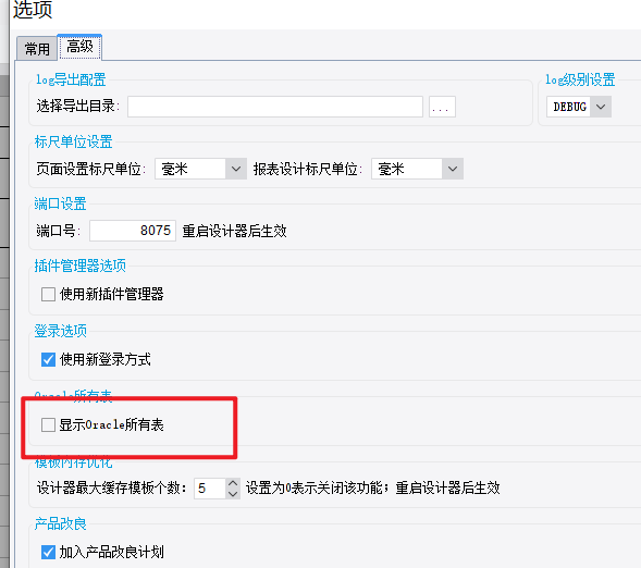

把浏览器默认设置成比如谷歌或者edge,然后再重启一下设计器看一下?如果是oracel不勾这个

检查一下数据连接配置,要看你本机环境能连上数据库服务不?
